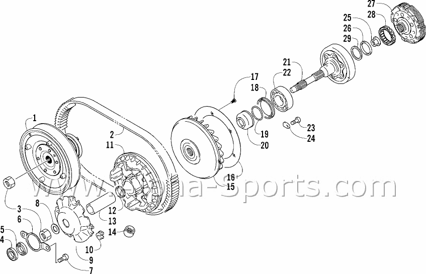

if its an 05 h1, then i beleave its #18 and they have an updated part # 0830-188  $11.11

Thanks 700Blaze, that will make it much easier for him. #18 it is!!
